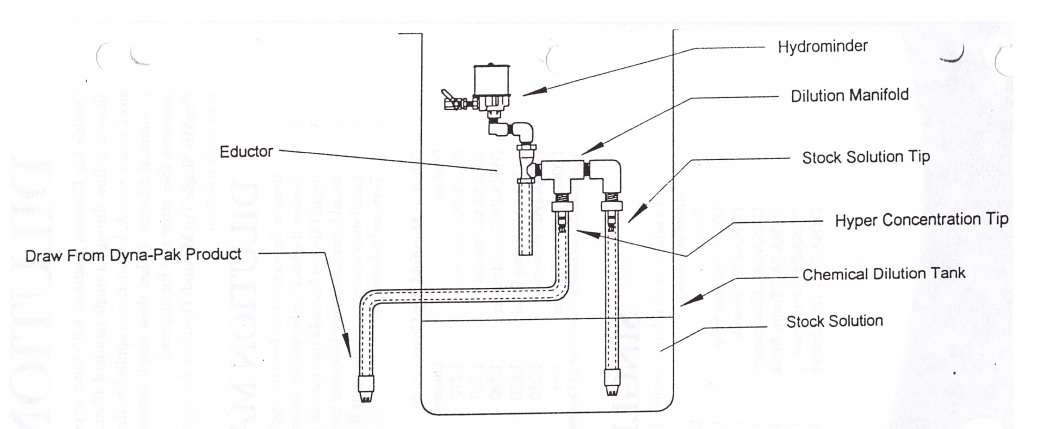

I've made and used a manifold by just adding a tee and a second eductor tip, then running a hose to the already diluted tank to reduce the suction of the other tip drawing from the bucket. Unfortunately there's not a chart for dilutions AFAIK, it's trial and error to find a setup that works.

Here's a pic of the layout - I've never used the foot valve in the tank as the restriction affects the dilution, and I've never had the tip clog.
