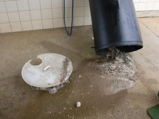

I just bought a wash a few months ago. The previous owner used pellets, I do not know what brand. This is what came out of the brine tank:
Between the two tanks there was about 100 lbs of salt that had broken down. If it get bad enough, it can fill up the space below your grid and choke the flow of brine going to your draw plumbing.
