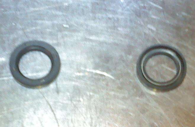

They look just like the low and high pressure seals. When you pull the head off, you'll need to pull off the ceramic plungers and the oil seals will be behind them.
