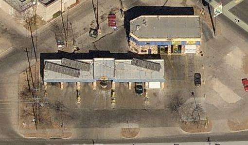

There was a local wash with a large array of solar water heating panels on the roof, but they were allowed to freeze and were ruined.
