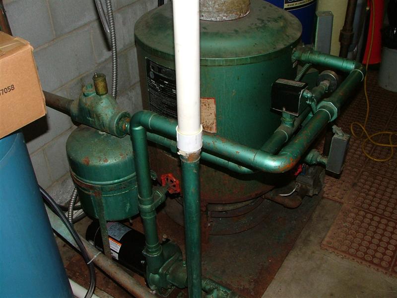

So I guess my system was purchased incorrectly or set up as a high temperature system! All I have is a gate valve between the pump and boiler which was set to wide open, full water flow. No Bypass. With the valve wide open, the water in the boiler doesn’t have time to heat because it is flowing through the boiler too fast. Anyway here is my question and which will hopefully help others as well. I’ve enclosed pictures for reference. Since all I have are my zone valves and gate valve between the pump and inlet of the boiler, should I restrict water flow to my boiler to get the temperature up so the system is more efficient? The way my system currently runs is like a car without a thermostat in the winter, the water will never heat up. So I need to add a thermostat, in my case restrict water flow through the gate valve to raise the boiler temp. If so, what high and low temp should I try to get to? I don’t know with my current configuration (without a bypass) whether I’ll every get my inlet temp above 125° to keep from hurting the boiler, but I can bring up the outlet temp to be more efficient. But I don’t want to damage the slab either with too high of temps. Should I add the bypass? My boiler is old but it sure would be nice IF I made the CORRECT changes to where it might last a few more years till I can afford new.

This is a photo of my boiler, no bypass, only a gate valve between the pump and boiler inlet...
I don't pretend to be a boiler expert, so take what I say with caution.
Personally, I wouldn't restrict the incoming water to your boiler, rather, I would regulate the output side instead. That way your boiler stays full and can heat the water to what you want before exiting. HOWEVER, for safety you should have a pressure relief valve on the output side of your boiler before the gate valve.
My boiler is different brand but the same concept. I also did not have a bypass line in mine. It seems as though at one time this was an acceptable way to do it, probably when gas was cheap. I installed a bypass my self. You want to run about 1/4 to 1/3 of your volume back into the boiler. After doing this I could get the proper heat settings from my boiler. Saved a bunch on natural gas. This idea came from some Raypak people, they told me that this is the current way of doing the plumbing. I also did not have a return line thermostat which I also installed at the same time. About 64 to 66 degrees seems to keep my bays from icing up
There is a pressure relief valve right at the outlet on the boiler. You can't see it in the pic. The gate valve is is on the inlet plumbing, not the outlet. Its actually plumbed different than what I expected. Cold in to the boiler is on top, hot out is below then expansion tank then to bays...Cold in from bays then goes to pump, then to top connection on boiler. This is a prebuilt system just like KR sells only without the bypass plumbing:

I have the boiler temperature at 115 degrees. Mine is a raypak with a modulating valve. I can adjust the temperature up or down if I need to.

Thats good information to know about the tubing. Mine is black, but it is very stiff and not like the flexible clear poly stuff I use for my mix tanks. I would think it would withstand temps higher than 80°-85°....But then again, if higher temps cause slab issues, then its a mute point. Maybe I do need to install the bypass to control temps to both boiler and output to bays. Sounds like the only solution to make it work more efficiently. Right now my boiler never turns off unless I turn it off or if the outside air temp goes above 30°. The lowest temp setting on the thermostat controlling the output from the boiler is 100°. Minimum temp setting on the input is 70°. I don't get close to either setting with the gate valve wide open... So it will run constant once the outside temps are below 30° if I have the breaker on. I've read that others are having the same issue...Some are putting the boilers on timers: On a certain length of time, off a certain length of time. I'm not the only one seeing this issue...
On a "house" boiler your boiler should run between 140-180 degrees any lower and it could condense and ruin the heat exchanger. The return water should be mixed into the supply water so no more than 120 degree water enters the cement slab.
I don't know much about these PVC piped boilers? Most of the time the cold concrete on outside systems never gets to the 140-160 temp anyway since the heat gets convected to the cold concrete so fast the boiler never gets up to temp(on very cold days) Sorry I cant help much here.
