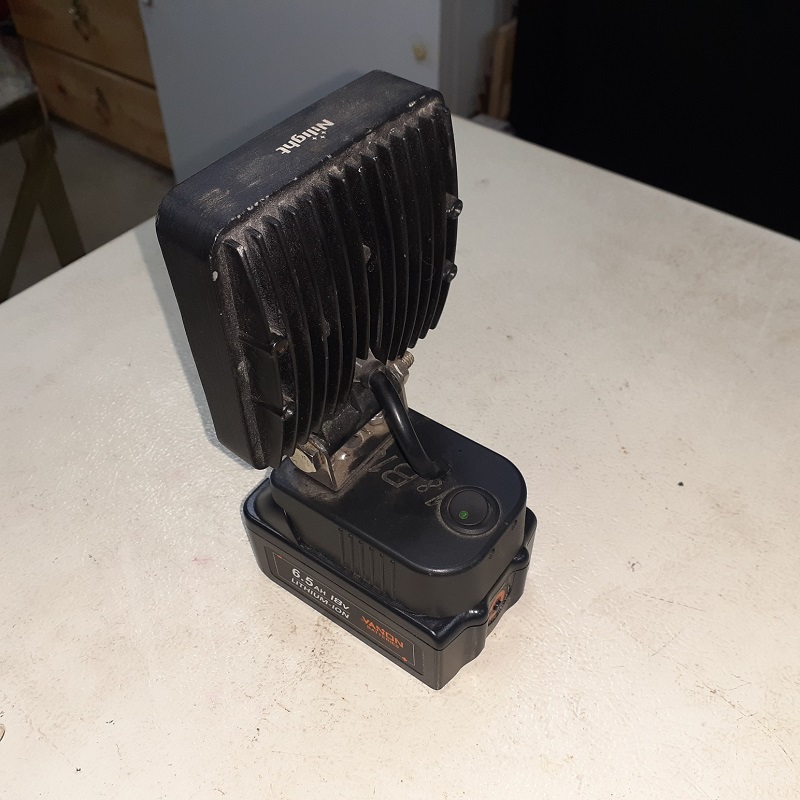

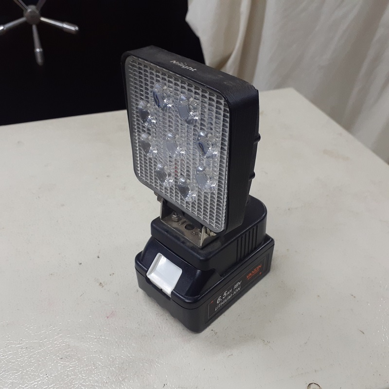

Changing it up a bit for today....I haven't found a more handy tool for the CW and thought I'd share....I made (2) of these flashlights a few years ago from 12-18v LED Off Road LED flood lights I found on Ebay. About $10 each....Most name brand Lithium Power tools have "Hobby Adapters" available for their batteries for about $7-8.00 each....Lit Toggle Switches are cheap....I get over 3 hours continuous run time out of a 6ah battery. Perfect for hands free working on a coin box, pump stand, in the attic, working on a car, etc. Hinged for the perfect angle. Sits where you put it! Who doesn't own several batteries for their favorite power tools? I haven't ever owned a flashlight that is as good as this.

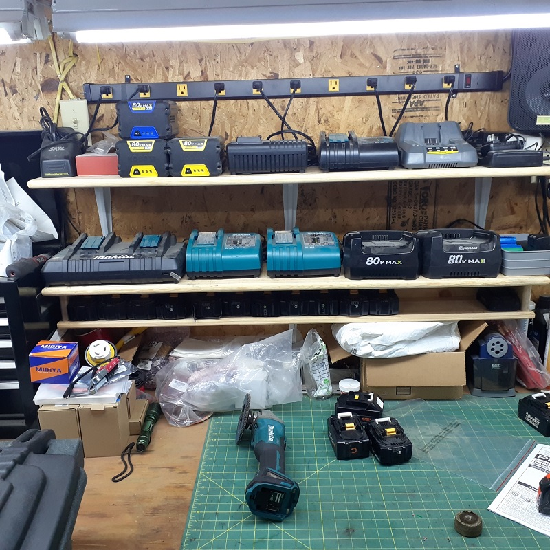

Charge Station....

I didn't know there was a "hobby adapter" for cordless tool batteries - I may have to build something like this myself. It's been more than once I was called to work on a wash with no working lights in the room.

WOW 2Biz what a great idea. My batteries are EGO 56 volt, I might have a hard time finding a LED light will take that voltage. I'm going to order a "Hobby Adapter" and play around with it. Some one left me a complete 18 volt Milwaukee cordless tool kit a few months ago. I've been waiting for them to come back and claim it but no one has asked about it. I hang on to things like that for 90 days before I claim it. I'm going to order a "Hobby Adapter" for those batteries. Great idea.

I've had LED rechargeable lights like this in the past, but kept getting burned by them either not lasting long enough, or never charged when I need them...Its much easier to just pop in a new battery when one drops below useful limit....As you can see, I have a few spares!

Like my E Gos. Have the Blower,, Hedge trimmer and 2 stage Snow Blower. Have a similar charging station with the power strip on a timer set for 1 hour a day.

That's why I got two of those lights, and I try to remember to charge one at least once a week. It's been a long time since I've needed a light that will run for hours, so the hobby adapter thing would be more of a novelty for me. I also have a Ridgid flashlight that uses my batteries, and it'll run 12 hours on a fully charged 2 AH battery. I have a dual head halogen light stand that was bought for a project and never even got used - I think I'll convert it to 12V LEDs and mount a couple of the adapters to it.

The charge station is at home in my garage. No way do I have any room for something like that in my ER either! You are not alone!
