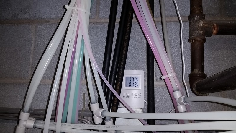

Shouldn't be a problem. Raychem advertises the cable is self regulating. It should not overheat....Mine gets to about 110-115°....Doesn't matter if it's only on for a minute or 20 days! Always the same temp! I have electronic temp sensors attached to the cable in the trough so I can tell if its working when activated....
Its just a cheap electronic thermometer with a temperature probe.... Here is a link to something similar on Ebay. $6.99 with free shipping.

Here is a picture of mine. I have 2 of them. One on both sides of the Er with the sensor probe laying in the trough. It also monitors inside temp of the Er. Dual temp output.
Your Welcome! Sometimes its the simple ideas that are the best. This one doesn't break the bank!
