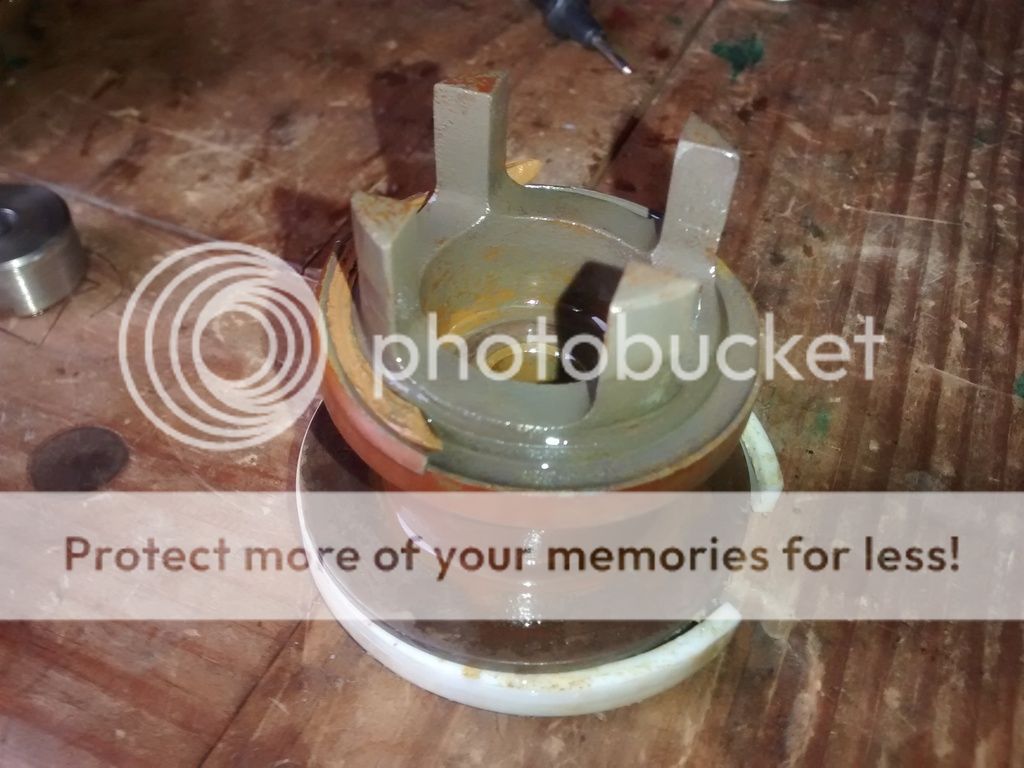

mrfixit
Apr 8, 2015
292
Northern Illinios
OK well the crimped seal on the poppet failed... This is probably what's wrong with yours.. The seal on top there..
Explains the parts of the seals clogging the nozzles occasionally.
