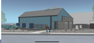

Love it. The petit model and long bays are the future. You might consider Dencar so you can have memberships. So yes the petit is the right equipment, maybe consider Dencar pay stations. As for evaluating car wash builders. I looked around and found a GC that had built other car washes. Once you get into the 3rd phase of architecture and have buildable drawings they can give you an actual quote. Most likely going to be looking at 1.4 million or higher for building and development of property not including any car wash equipment. My budget for a 2 bay version of what you are building all in is 2.3 million. My bays are 60' but if I had the room I would have went 72'.
