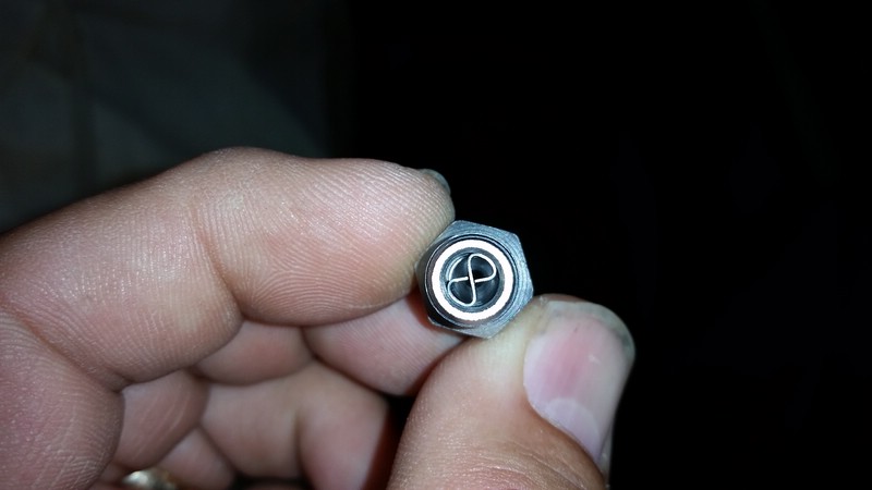

I purchased some I-Meg tips and was wondering if anybody has experience using them? I haven't had time to try one yet. They have this weird looking SS figure 8 insert in the inlet. Will this be more problem than its worth? Are the I-Meg tips better than the standard Meg?

That insert is a stabilzer vane, for use on nozzels that come from the side of a pipe like an inverted L arm. It directs the flow better.
It's easily removed for use on a gun. Just stick in needle nose and twist and pull. I don't think it hurts a lot but not needed with a gun.
