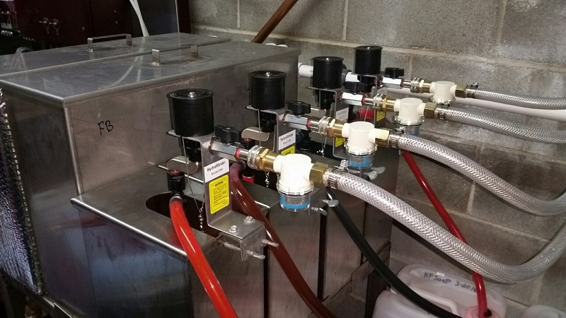

Quite a rabbit hole I'm down on the revamp of my wash. Now that the chemicals are updated and not the same soap for 3 functions I can see that there are leaks in the walls separating the tanks. Was thinking about flex paste but worried about chemical resistance. Getting it welded is way too big of an endeavor right now. Was thinking a thick plastic rectangular container to drop in would work and last indefinitely but not sure where I'm going to find that.
You might look for a tank to have repaired, then swap them out.
I haven't looked at this part closely but the tank just comes off the stand on these coleman racks?

If I could find a thick mil plastic bag with a port like soda syrup bags or something that might even work as a band aid for now.

I have successfully used silicone sealer and Flex tape to seal the partition on my D & S SS tanks. It's an inexpensive experiment.

5 gallon bucket with lid is $3 at Firehouse and will work for a long time, I've seen them used in tunnels as a temp fix that became permanent. Hang on wall with a hook, and drill/cut lid as needed.
I'm not positive, but I believe so. They often come with a second set of tanks to the right that you're meant to pour the chemicals into. I'm not positive, but I think it's the same tank without any bulkheads welded in. It just sets into the frame. Those are often sold because people would rather pull out of 5 gallon jugs.

The purple stuff left a crazy crust in the tank, a good 1mm thick on the walls, discharge tube, will have to get a pic of the float tomorrow. Do all tire cleaner type products do that?

I'm going to try flex paste tomorrow. Because the tire cleaner is down I drained that tank and could see the .75" spot at the bottom of the dividing wall where liquid is getting through. I'll probably just do wax/soap right now, put some solution in 5 gallon jugs and let the sealant cure at least 24 hours. If it buys me 6mo-1yr that's fine. Do I have to hang jugs or is the siphon sufficient to leave the jugs on the floor and run hose to solenoids?
You can see an entire 3/4" gap?
