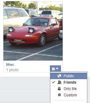

To post an image, you can either attach them (which means editing the parameters) or upload them somewhere. You can use Facebook and create a public album, or a free service like Photobucket or Imgur.
Quick test to see if Google Drive works
A little convoluted but it works and it's also free.
You have to make the album public.
