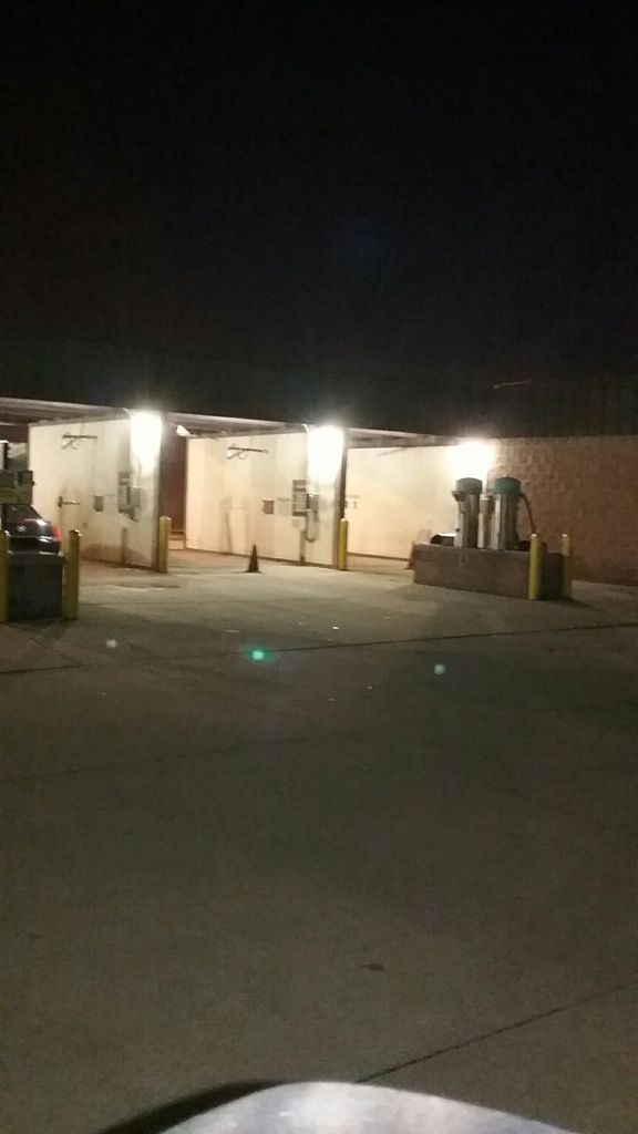

Thought I would try this corn style bulb. 54w instead of 105w that the CFL pulled.
The far right bulb is the 54w corn style. The rest are 105w CFL
