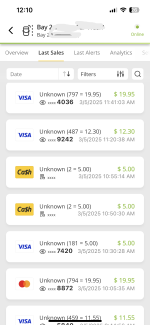

FYI...
This is how MOMA displays "Last Sales" with CA$H reporting.
(This location setting reports coin counts in $5 increments)
