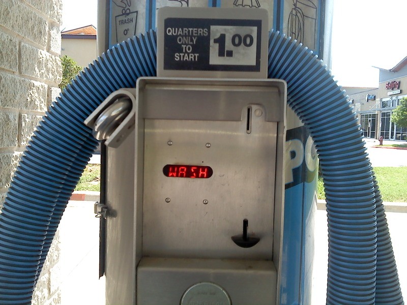

I've cut the openings for timers. It takes some time to do it neatly but it doesn't cost much if you have the tools already. I did some vacuums by drilling two holes with a step drill and finishing with an angle grinder with a cutoff wheel.
Did mine with a roto zip metal cutting wheel. First one I drilled holes at corners and cut slots to the holes. Next 3 I just cut the slots almost to the corners on one side then on the other and finished with a dremel cutting wheel. Drilling mounting holes and cutting was about 30 minutes per door. I mounted mine as low as possible with the credit card swiper above. 4 doors used 2 cutting wheels.
The door I pictured above took me maybe 15 minutes from start to completion, including drilling/tapping the four small holes for the screws so they would act as mounting studs.
Was your step drill "Cobalt" . You are fast. At 1 minute to drill and one minute to tap and insert bolts, that is 8 minutes, then the 2 step drill holes and cutting in 7 minutes. (Not to mention layout / marking time.) More than one drill chucked and ready before time starts? :)

Harbor Freight step drill set, used a Harbor Freight drill press, maybe a minute per hole. The holes were drilled with a good quality 1/8" cobalt bit which is slightly oversized for a #6 screw, but then I can just chuck the tap into my drill, so the four holes took maybe 90 seconds drilled and tapped. The rest was cutting with an angle grinder. I didn't count setup time, so yeah it probably took a half hour all in.
