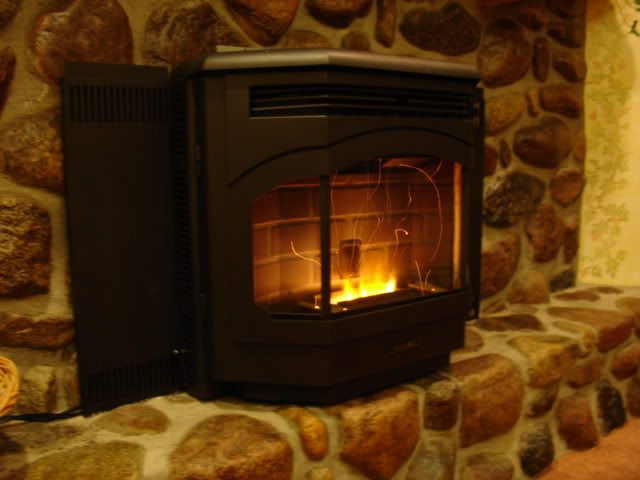

I'm not sure if this would work Dave but I recently bought a wood pellet stove and notice in my research that there are pellet furnaces and boilers. Most of these heating devices will burn corn also, or a 50% mixture of them. But corn is up right now. Wood pellets bought by the ton is reasonable. And have burn times of over 24 hours. And so efficient that they don't emit smoke. You would have another chore of stoking the fire each day. But I don't mind it. Our house has never been this warm. I'll try to find the link to the boilers. I'm on propane and right now it's over 2.00 a gallon. This way of heating beats propane all to hell. Do a search and you will find many different ones. http://cgi.ebay.com/150-000-BTU-ALT...R-FURNACE_W0QQitemZ350004076448QQcmdZViewItem
