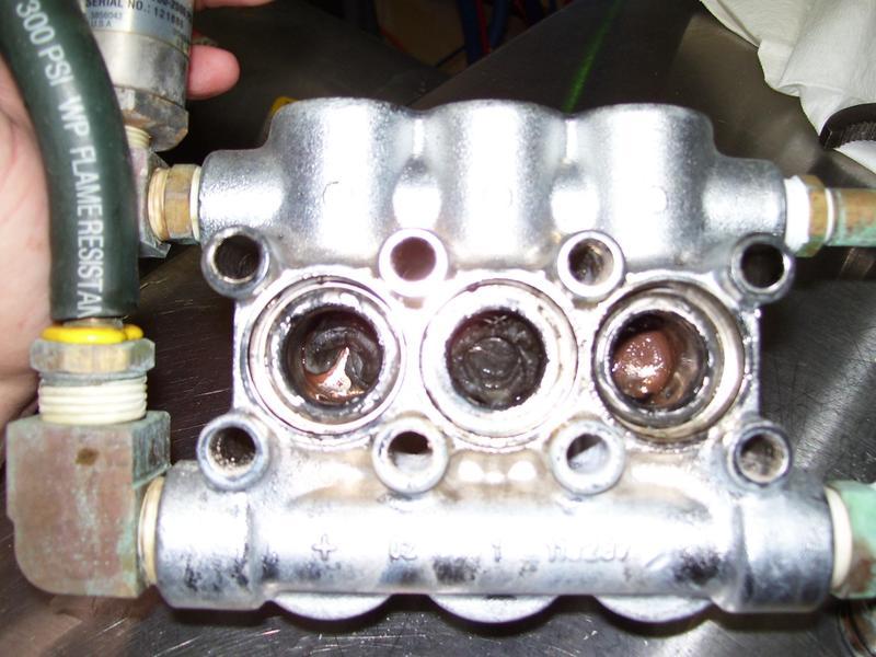

It sounds like while the bay was frozen someone came in and used the high pressure system left it On. The water flowing though the pump is what cools the pump. If you don’t have any water flowing though the pump it will over heat causing the seals and if run long enough the valves to be damaged. You need to rebuild the pump head. Or like Diamond said it's still frozen.
The low-pressure seals are fused to the oil seal retainers.
Sometimes just the back-up rings on the valves melt and disappear. That alone will cause it to pulsate.
aca - if this is what happened, a thermal relief valve could help this situation. It dumps the pump water onto the floor when the pump gets hot. It helps prevent the overheating.
Ideally you shouldn't need them, but it's good insurance against the damage it can cause to the pump. The parts alone to rebuild the pump I pictured cost about $250. The thermal reliefs from Cat work, but they just spray hot water everywhere. I've been scalded by one before.
