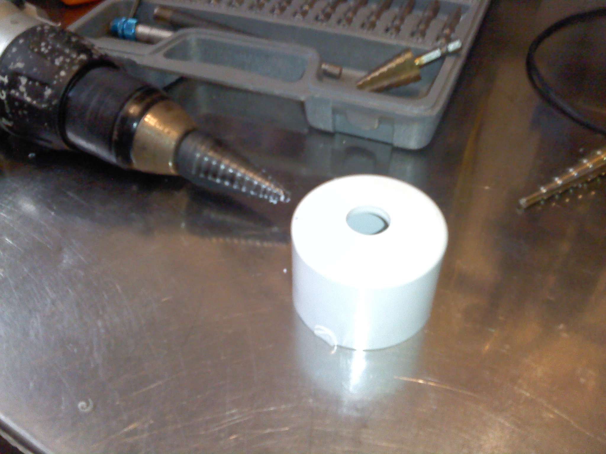

Cricket season is coming soon, and since I had to change some Hydrominder hoses anyway I came up with a very cheap way to keep the bugs out of the chemical buckets.
A 1/2" barb splice and a 1 1/2" PVC cap (About $3 at Home Depot):
Drilled a 5/8" hole in the cap:
Cut enough of the hose off above the foot valve to reach the bottom of the pail and attached barb (Not pushed quite all the way in):

I thought about that before I used the PVC cap, but 1) I wanted something that I could just drop in the bucket that would fit snug over the spout, and 2) they keep changing pail lids and the caps are different.

I've been using those caps for years (I used to pour the chemical into the square containers because the pails were solid yellow) - it sits on the spout but doesn't cover it. To try and keep them in place on the hose, I slit some 3/4" hose and zip-tied it around the pick-up hose. The Hyrdominder hose eventually hardens and shrinks, at which point the 3/4" hose pieces slide around and the cap is no longer in the right place.
I wasn't going for a fully airtight seal, I just want to keep bugs and dust out.
