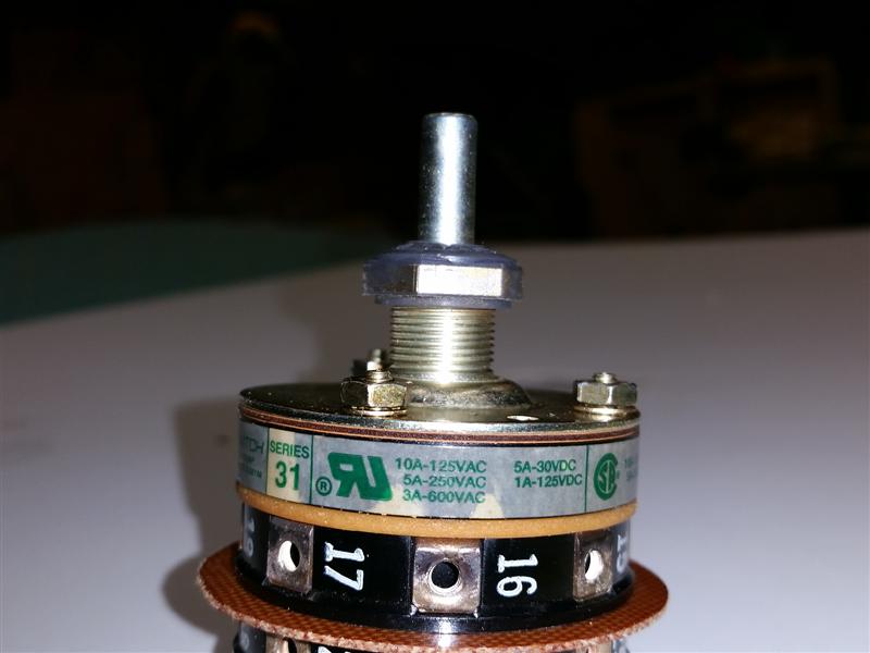

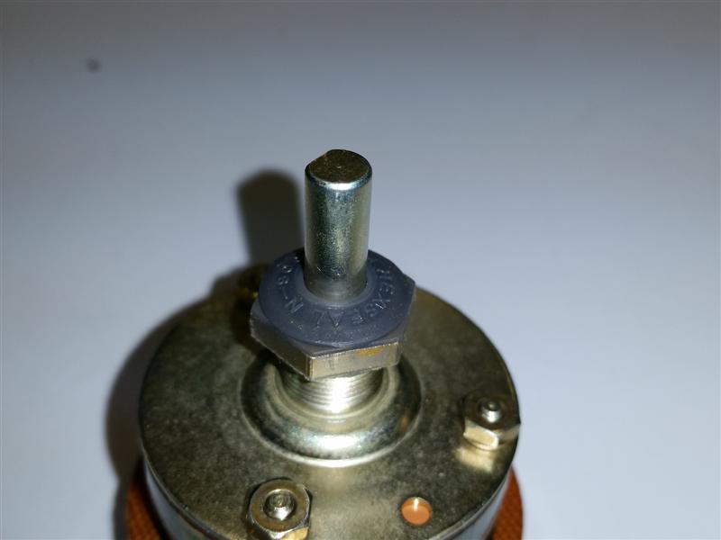

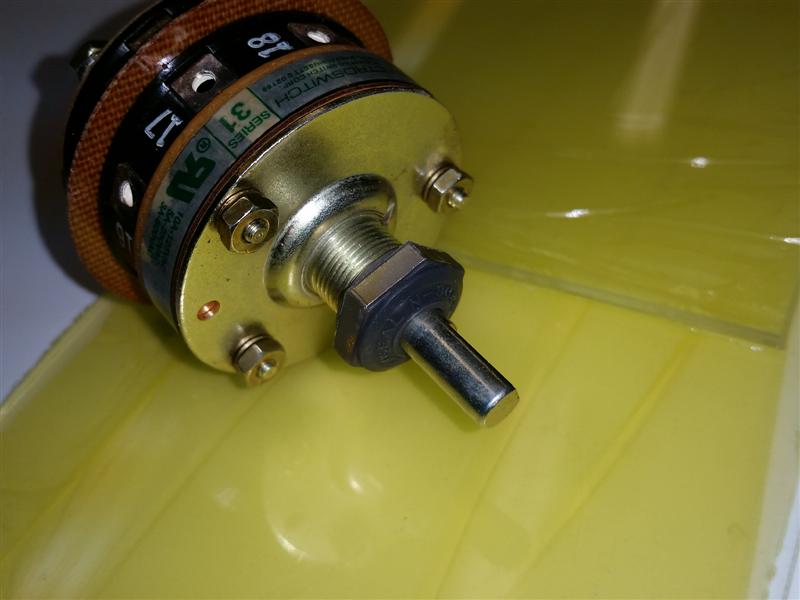

I got the rotary Switch Seals in today. They fit the electroswitch perfectly and looks like they will definitely help keep moisture out....Damn, the new smart phones take great pictures, even closeups!

Are you going to use the "seal" nut to mount the switch to the door?
Or perhaps another jam nut against the "seal" nut to prevent it from spinning over time?
Just trying to figure out how exactly that seal will be used.
2,818
431
Good question, and one that I was already contemplating! The nut is metal and also has a rubber sealing surface on the face of the nut that could go against the faceplate or the face of the outside nut. I'm hoping there are enough threads left on the switch to mount the switch as usual (nut on inside of faceplate and one outside) and run this nut against the outside nut. I'll let you know what it looks like all stacked up.
