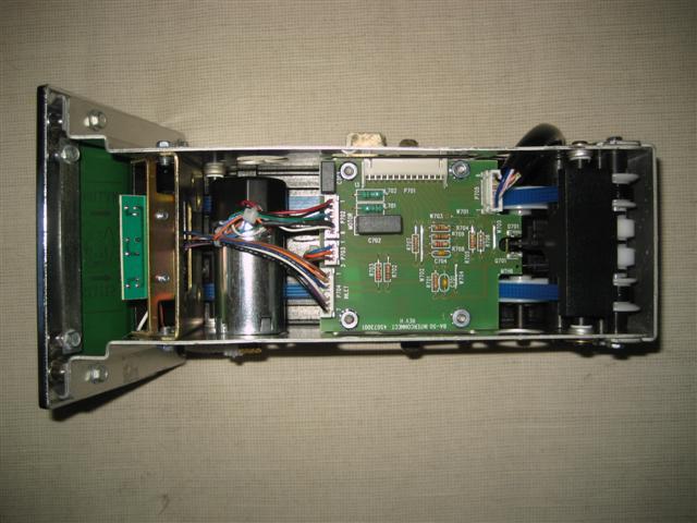

All of our self-serve change machines are Rowes. We probably have a total of 12+ BA-50 bill acceptors. When their bill acceptance declines we put in a new one and get the old serviced locally. The local service company's quality control has been in the toilet this past year, not sure why. Sometimes we'll pick up a newly serviced validator, plug it in to a changer and it won't even accept a bill...belts too tight...motor speed is off....you name it. I'm thinking I would be better off boxing up the bill acceptor and shipping it to a better service company. If I were to do that, who would I ship it to? Anyone having good luck having their BA-50's serviced?
We have a few Rowe bill changers that had the BA-50 validator installed. Do yourself a favor and convert them over to a Mars validator. 99% of your problems will go away. The acceptance rate and longevity are much better than the BA-50.
I 2nd Kevin. Get rid of the BA-50's. I did that 1 month after buying my last wash and haven't had a complaint or issue since. Been over 4 years now. With the Rowe's, I was having issues every other day.
I can get Mars factory serviced usually under $100 and they come back like new, even if they've been in a bay for 10 years. IMO Mars conversion is a no-brainer.

I have had great luck with ChangeTec out of Grand Rapids doing my full rebuilds. About every 4-6 months I instal new black belts. Doing this gets me one to two years depending on the location of the changer. I have some changers in an alcove and they last super long. I also clean the belts weekly with alcohol. I would go to the mars conversion but I really like the bill separation in the stackers.
You could look at your lower belts.... mine were blue from Rowe. But you could call Rowe and ask what color they should be? When I was getting bad performance from my acceptors the belts were green.
