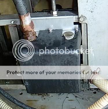

So just out of curiosity, is anyone else besides me seeing water get into the high pressure pumps on these? My company does maintenance on some of these, and we follow the factory recommended maintenance very closely. When a little while back, Mark VII changed from the Arimitsu back to the Cat pump, we saw water getting into the crankcase in the first 30 days. We do a PM at these and are there twice a month. I've seen this on three machines now, and that's every one we deal with. So, my questions are: 1. anyone else seen this? 2. What have you done to correct this? 3. Does anyone have a factory fix for this? 4. What has worked to fix this? 5. Has anyone moved the pumps indoors to fix this? Any info greatly appreciated. If I am screwing something up, I would really like to know what that is.

It was to be expected that the on gantry design also affected the Cat pumps, too. According to a former Mark VII employee, the Arimitsu pumps out lasted any pump they have ever tested - including Cat - but the constant rain shower was too much. It was easier to blame a little known pump brand than admit a design flaw. The Cat pump has special epoxy paint, liquid gasket, and other water excluding features not found standard on any other model and the pumps still get water into them. The Cat warranty specifically excludes coverage for water in the oil, so Mark VII can't even get warranty.
I think I.B. has talked about a plastic cover, or helmet, that some lucky individuals were able to receive if they really complained. I know Arimitsu has helped all the owners of equipment that have contacted them. You may want to talk to them, too.

When Mark VII designed the GT series machines Cat did not have a pump to meet their requirements. Arimitsu had a pump with the specs they were looking for so they went with the 709 on the GT machines. As with most pumps, it was not made to be run it a constant wet environment. They had about a 5% "under warranty" failure rate due to water in the crankcase. In the meantime, Cat developed a pump for this application and Mark VII used the "water in crankcase" issue as the reason to drop Arimitsu.
Since the pumps only run 30 seconds or so at a time, I doubt that they generate enough heat for any condensation.
Arimitsu has a seal to put between the head and crankcase to help this issue and Mark VII has a plastic cover.
The Arimitsu people are great to deal with and are always eager to help. I have never seen anyone from Cat or General contribute to this forum. I currently am running 12 Arimitsu in my SS bays and have 6 on my Mark VII autos. I won't ever buy another brand if I can put on an Arimitsu.

Thanks for the replys. As to the condensation issue, there is undoubtly some of that going on. Since the crankcases are ventilated, moist air gets in during the day, and condenses at night when it cools down. You will only get small ammounts of water this way. What I've seen is two week old Cat pumps with a LOT of water in the oil. The first time I asked Mark VII about it, the tech actually said the solution was to use Cat oil. Now imagine finding oil in your auto crankcase, and then have a tech say to just use good oil. The reason for this post was to see if others are seeing this issue, and what fixes have been done. In theory, it would not be a major modification to move the pumps indoors, but it would still cost a bunch. Right now the customer that I have has three of these machines and mark VII, the distributor(Waltek), or Cat pump will answer their calls. Ain't life grand.

Try putting a tube in the cap on the pump and run the end as high and far away from any water spray as possible. Trucks have a similar tube in the axle vent to prevent water from entering when they are fording. If a Cat pump gets wet directly on top, the cold makes the air in the crankcase contract and any water on the cap is literally sucked into the crankcase.
The tech is correct about using Cat oil because it will absorb water and maintain lubrication, whereas non-detergent motor oil cannot.

I bought a new GT500 four years ago and both of the original Armitsu pumps failed within 18 months and one of the replacement Armitsus failed last year. I now have Cats on both sides of the machines. I just pulled a ten year old Mark7 out of service and I never touched the Cat pump on the machine for seals or any other problem. Changed the oil every couple of years and that was it. I have some 623 cats at my first car wash that are still in service after 26 years. With that being said I went through the washout problem with the 310's like everyone else and almost switched to Armitsus four years ago and I am confident they are a good pump. I went with the Cat 5cp instead and out of 6 pumps I bought 4 years ago I have only worked on one(seals). I have bought several more since then and they have been trouble free also.

After a sabbatical, I?m happily back at Mark VII. Our CAT pump warranty is 5 years. Within that 5 year period we have a 3% pump failure rate. Mark VII offers pump covers (p/n 3500-0030, $29.99 list price) for additional peace of mind. The reason that the tech support staff said to use CAT oil is that we have found there really is a difference. CAT oil is hydrophilic, standard oil is hydrophobic. Meaning that, CAT oil will combine with water without significantly separating. As such, if water enters the crankcase, the bearings, journals, crank, etc. are still protected. As a Mark VII employee I may be biased. However, having worked with our customers for years I can assure you that our warranty processes and policies are liberal and fair.

Our friendly CAT representative explained to me that water in the crankcase, causing lubrication failure and subsequent damage is usually not covered if the water entered due to seal failure. An important piece of pump maintenance is to ensure the LP seal is in good shape during an oil change. To the best of my knowledge, Mark VII published a Technical Bulletin to our Distributors on May 20, 2005 describing mitigating water problems. The pump cover was originally designed for Arimitsu pumps which appeared much less tolerant to water spray. Hope this helps.

The covers were designed for the Arimitsu and we haven?t had any significant after-market demand for them after switching to the CAT pump.
