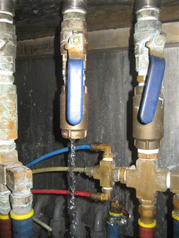

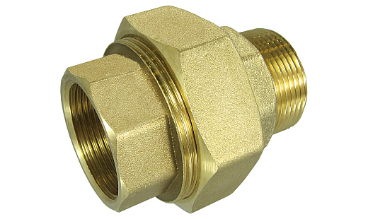

The check valve that keeps the weep from backing up into the tank is under the tank. There's a manifold for each bay with soap, wax and rinse all coming together under the check valve. I have had to replace a check valve there, and rather than shut most of the wash down and disassemble four bays worth of plumbing I just cut the nipple at the check valve and put it back together with a union.
I totally forgot about that check valve. Has to be one of them that is bad. When I left, the tank had held stead for a bit, so the leak must be very minor. I will just keep an eye on it for now.
I like that idea!! I dont understand why Coleman puts them together the way they do? They should come from factory with either a union or a non working swivel in there somewhere! I have been lucky not having any real issues with mine YET! But my idea when I do have to do something with it was to put a swivel in. I will heed the advice to get out the sawzall and hack away. Thanks.

It took me awhile in the beginning to figure out why my float tanks were over-flowing with the weep running...Who would have guessed my back-flow CV was embedded inside the Giant Unloader!

This repair is not that time consuming.... But you do need to dismantle the parts to remove the valve. I also agree a non working swivel would help.... But it would probably not work in 10+ years when the valve needs to be replaced again? I also did not drain the water and just screwed the new valve on.

You don't need to dismantle the parts to remove the valve if you cut the nipple above the valve. I've done it several times with a cheap plastic hacksaw blade older, it takes a half a minute to get through it. Just cut below the hex above the check valve and you can remove the remainder of the fitting from the ball valve, and the remainder will get thrown out with the bad check valve..
I've never had a brass union like this not want to unscrew 20 or 30 years later.

I agree I have never had a brass union go bad either? (But they are usually expensive.... That is why someone already suggested a non-working swivel. Which will probably not last 10+ years.)
But to be honest.... that brass check valve should probably last the 15-20 maybe 30 years also?

The one I've worked on had 7 bays, so the manifolds were so close together there wasn't even enough room to unscrew the cross with the three tubing lines on the bay with a bad check valve, so I would have needed to disassemble and remove four manifolds. It didn't help that it was the middle of summer on a 100+ degree day and they had their 700,000 BTU boiler running with no vent to outside, so I wanted to get it done as fast as I could.
