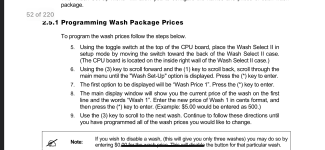

Hi all,
Im wondering how do you tell this machine cycle1 is $14 and cycle 3 is $10? Is it somewhere inside it? Or on the computer in the office? Or on the main panel inside mechanical room?
