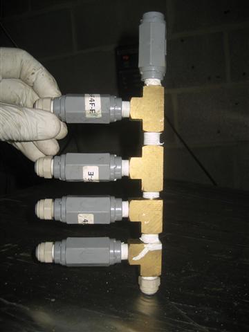

I have been out of town for a few days, but was able to get KR to agree to accept the check valves. They will send them to Fluid Controls for evaluation, but will credit me even if they are repaired or replaced. In the meantime, I need to buy replacement check valves so that I can remove the bad ones. I bought the FC valves based on all of the feedback from here, but now need to go in a different direction. Considering that I am using these for weep and chemical on only FB and TF, what is my best bet?
I climbed into the attic earlier today and put on 2 old used cheap check valves and they worked fine. So the issue is the FC Teflon valves for sure.
