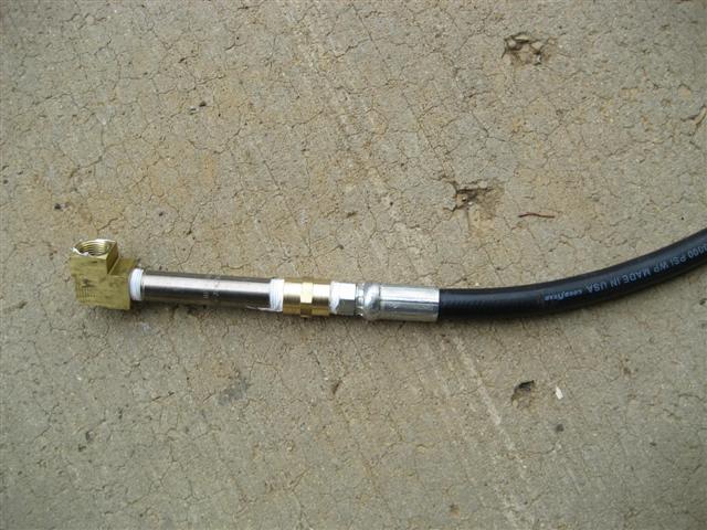

The hose and ss pipe runs horizonal in the boom and the vertical hp gun hose attaches to the elbow. My hp hose would wear at that location.... the ss pipe fixes that problem.
Some booms have a ss spacer and an elbow at that point to attach the hp hose.
