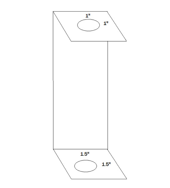

The mount should look something like this:
This will make the boom swing to the right. If the holes are the same top and bottom, you'll need to shim.
My first guess would be that you've got the mounts upside-down.

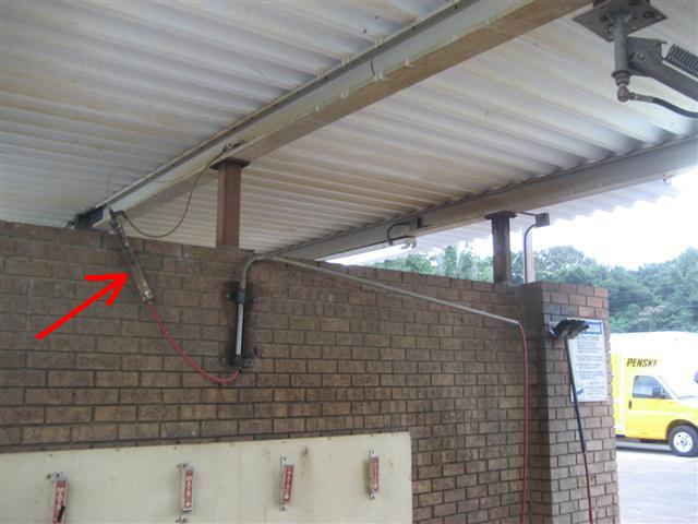

This is how I mounted mine. I used PVC mounted to a piece of plywood to run the hoses through. Then cut an additional piece of half inch hose about 8-10" long and used it as a sleeve or protector on the hose to keep from cutting the hose on the sharp edges of the boom mount.

No Swivels. Just 2 pvc couplers and a short piece of pipe sandwiched to the plywood. The poly braid hose then goes from the ceiling over to the trough in the attic. I have that hose insulated over to the trough. The Previous Owner had cut a big loop in the ceiling for the hoses. Birds and criters would get up in the attic. Drove me nuts...Thats why I have plywood there. The PVC helps protect the polybraid when it pivots back and forth. Been like that for 3 years now. No problems.

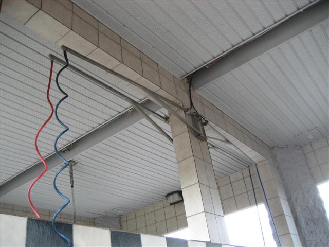

Here is my booms. They are close to the ceiling. Should I use the pvc or cut a square hole?

I don't think the problem is with the hoses. It appears that the top of the boom mount is farther away from the wall than the bottom. The booms are going to want to swing away from the wall. If you flip the bracket over and drill two holes in the way I outlined above, it will swing toward the wall on its own.

The holes are the same distance out. If I shim the bottom of the bracket out should this take care of my problem?
When the boom it stuck out.... is the lp hose between the boom and the wall? Or outside of the boom like the picture?
It looks like the boom and the hose are conflicting? I think the boom needs to be lowered. But if you add more lp hose slack the hose might not allow the hose to go on the wrong side of the boom? (Between the wall and boom.)
It should help. There needs to be something to help the boom return completely to the wall. Tilting the bottom out will make the boom try to lean toward the wall, but it will also increase how far the end of the boom swings. You might have to lower the whole bracket.
MEP001 - Can you explain more in detail on how this works? Does it work with bearings that hold a shaft and swings back and forth? I can take pics to show you more in detail what i'm talking about.
Look at the pictures above - it should be pretty clear how it works. It's very basic, no bearings.
