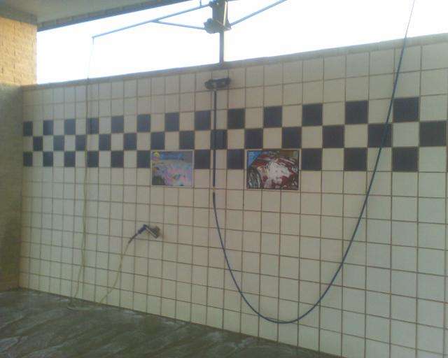

I heard a similar story from another local operator who built a wash with tri-foam. He put the foam brush hanger in the middle of the wall opposite the bay meter and put the tri-foam gun in the farthest back corner. He had poor use like you and eventually pulled it out. He even told me that people would select it on the switch and couldn't find the gun. When I installed the foam brush and tri-foam booms and hangers, I put the tri-foam at the same end of the bay as the meter so customers going to the brush had to walk past and see the gun, and when they select tri-foam it's right in front of them. Use seems to be better than ever - a set of buckets lasts about three months.
