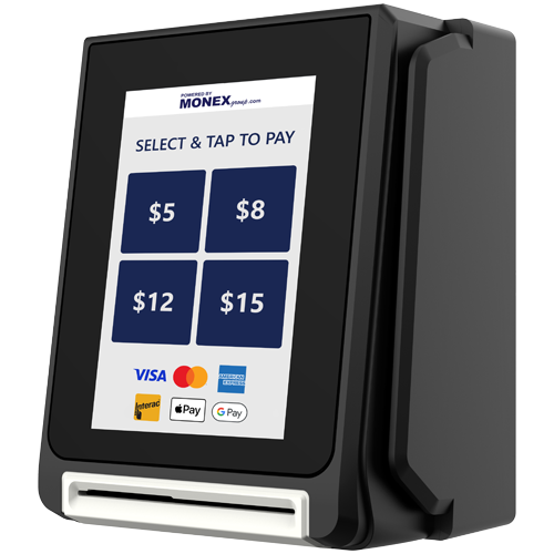

Monex offers a solution that works with pulse and serial. No retrofitting required.

Do you have link to a web site? or more information? "Monex" doesn't tell me squat!
Here you go......
5,891
2,271
LOL! I looked at it and there's no way for the Monex equipment to tell the Pay station how much to charge when the customer selects a wash. There needs to be an interface between the Monex reader system and the Pay station controller. The Monex system might work OK if the car wash had a single price for all of there wash packages and I lived in Canada. LOL!!

You can set the four charges directly on the device.
