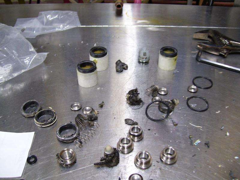

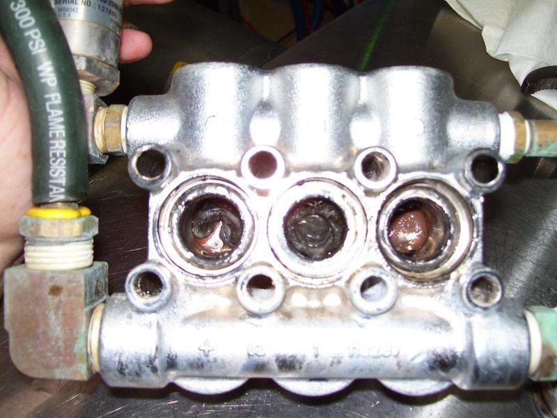

There have been multiple times over the last twenty years....that the ON switch was inadvertently left on.....usually during maintenance. This resulted in giving away free time.....and/or worse.....leaving the bay ON, pumping soap and water down the drain overnight. Ugh.
Or this can happen:
Note that the low-pressure seals are fused to the seal retainers.
The black melted stuff is what's left of the valves.
