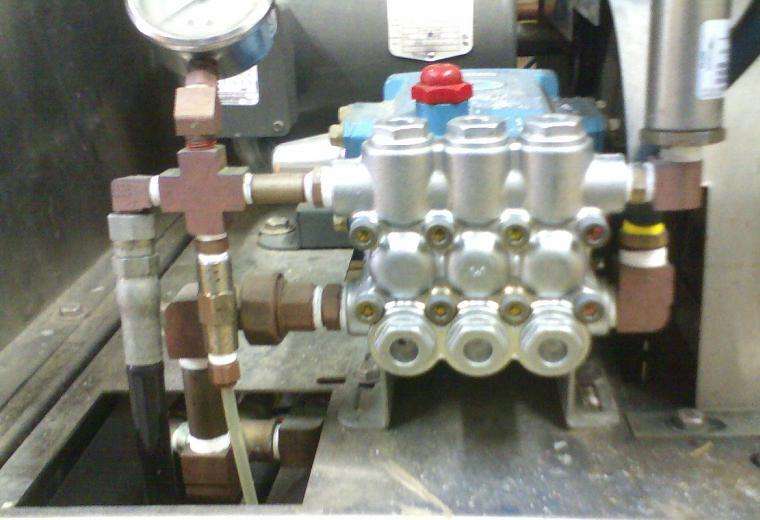

This is how one of my pumps is plumbed...using a regulator setup instead of an unloader.
The Black and Blue 1/4" poly tubes (next to the braided water supply hose) are soap and wax...all liquids feed into a single pump inlet. Simple, easy to work on, and reliable.
Uh oh, looks like I need a new belt!?! :eek:
3,948
They were originally plumbed like this:
Not a good layout; when the trigger was pulled/released the water flow in the head changed directions and the pump would cavitate for an instant. I had to replace the first head from washout in less than two years. As I replaced heads I replumbed them like this:
They run smoother, and none of the replacement heads have washed out (The oldest is seven years). It's also a lot easier to service with just two unions to break loose and free up all the plumbing, and I can keep a rebuilt head with a gauge already on it on the shelf to swap out in just a few minutes.
There was no change in the soap/wax draw with the change in plumbing.
