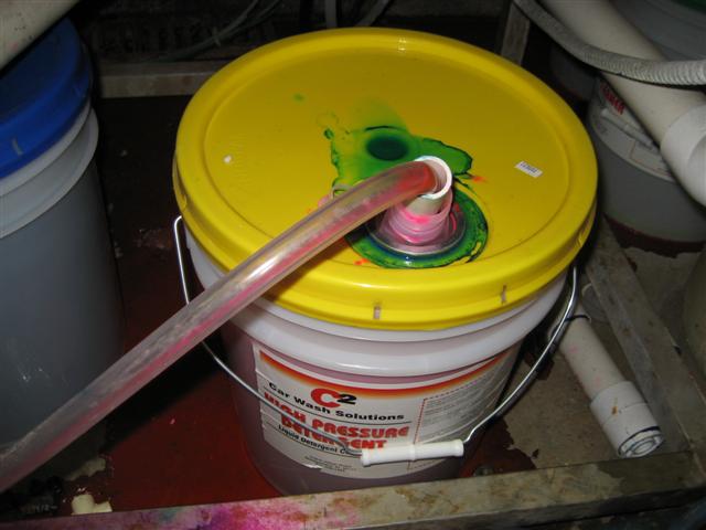

The thing I see wrong in the picture cwguy sent was not only the foot valve was bad but he is still using the old 1/2 hose. You need to change that out and get the 1/4 inch and you will be a lot better off. The 1/2 will give problems where it connects to the hydrominder because of the weight of the hose. When you think about it you don't need that much volumn of soap to go through that tiny little hole. I'll try to get some pictures of my set up.
Just because it's different from the way you like to do it doesn't make it wrong.
The reason it comes with 1/2" hose is so there's no restriction of the chemical through the hose if the Hydrominder is used with no tip.
