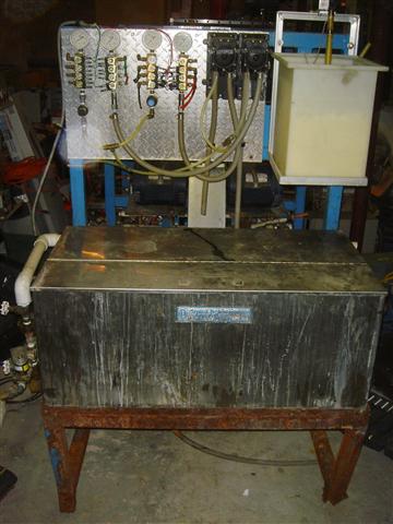

Revamping my foam brush system.

There's nothing complicated to a foam brush system. A local guy uses a large piece of plastic for the board. You can pick up a Baker's Choice cutting board at Sam's for about $12 that would make a nice-looking board, and it will never rot. Get two sets of block solenoids and mount them to the board, get a FloJet pump with the quick-change bracket, two air regulators (One for the air to the bay and one for the pump pressure), about an hour's work and you have a new system except for the tank.
The foamers aren't necessary, but you will get more foam with less use of chemical. Just don't pack them too tight or you'll get too little foam that will be too thick and dry to flow well.

So there is no pump? You use city water pressure?
It's using a motorized vane pump...on the left.
The old school systems were powered with city water pressure. I converted many water pressure/dema injector systems to Flo-jet power in my day. What a pain in the posterior they were...way too many things to adjust...way too many things to fail. An inexperienced operator or attendant could really screw up the entire system by making trial and error adjustments. One operator actually filled his air compressor with foam brush soap!
I just updated my post then you pointed it out also. I was wondering what was going on? :)
I believe that the regulator is the issue? They are super annoying to adjust and I would replace it like mep1 said or just purchase an idx controller.

That's another option, but it would take a lot more work and cost about the same to redo the system with a pump controller. FloJet pumps are very reliable if they're supplied with clean, dry air.

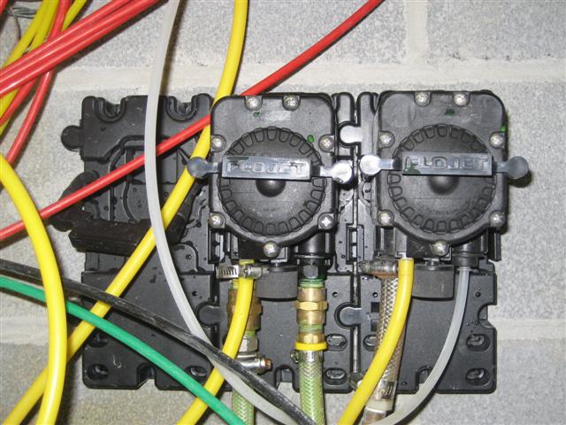

One Flo-jet G57 will easily handle a 4-bay system. It's very rare that all 4 bays will be using FB at the same time. Regardless, my busy 8-bay uses one Flo-jet G57.
A couple of 4-bay Kip solenoid blocks, a couple of mini air pressure regulators, a handful of push-to-connect fittings, 2 spools of PE tubing, a blend tank (5 gallon bucket?) and a 511 Hydrominder will get you well on your way to revampation.

Ordered the flojet 57 today! Got 2 manifolds as well with 2 regulators. Already have plumbing to the bays for the brush so it should be a breeze!!
Good choice based on some good advice.
I see some galvanized fittings in your old setup, good chance that they gummed up the works and thats what caused it to fail. Dont use any galvanized fittings in your rebuild, for that matter dont use them anywhere ever. And if you have it anywhere else, replacing it will save you some emergency headscratching repairs down the road.
FWIW, I do not use foamers. Air and FB soap are pushed out in separate hoses to the mainfold at the top of the bay, then T'ed together into the boom hose. Prior to installing a new brush head, I shove a bunch of plastic scrubbie material into the brush head and handle... so in a sense my "foamer" is the last 6 inches of the handle and the brush head itself. One less thing to deal with IMO and it works good for me.

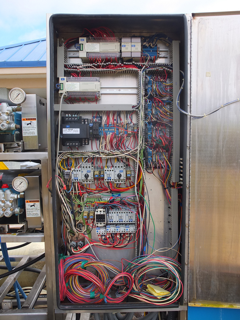

But I don't think purchasing all new equipment (pumping station) is always better.... also a PLCs might make systems more complex and harder to troubleshoot? :)
wow my Super Saver pumpstand wiring is totally different then that!!!??????
