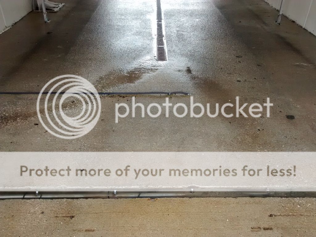

OK, its weird that its only x5 that flickers... Yes over running the back is an ongoing problem. Typically it only occurs on the third round. Ryko techs have replaced US a couple times but the issue persists.
I have monitored and it doesn't fall out of range. The rear US however were installed without spacers and attached with zip ties. I think I need to recalibrate all the US settings for distance. And probably add the spacers on the rear US...
Floor has been cleaned, all that's there is a bit of a worn spot from hose drain and the undercarriage hose.
It also will not wash a corvette anymore for the last 3 years, I assume due to the US reflecting off the glass or rear end.. It does 1 1/2 presoaks, but then drives into emergency rinse at drivers rear corner on second pass.
I was gone for 5 years, and I'm trying to get all this straighten out now.
mrfixit
Apr 8, 2015
292
Northern Illinios

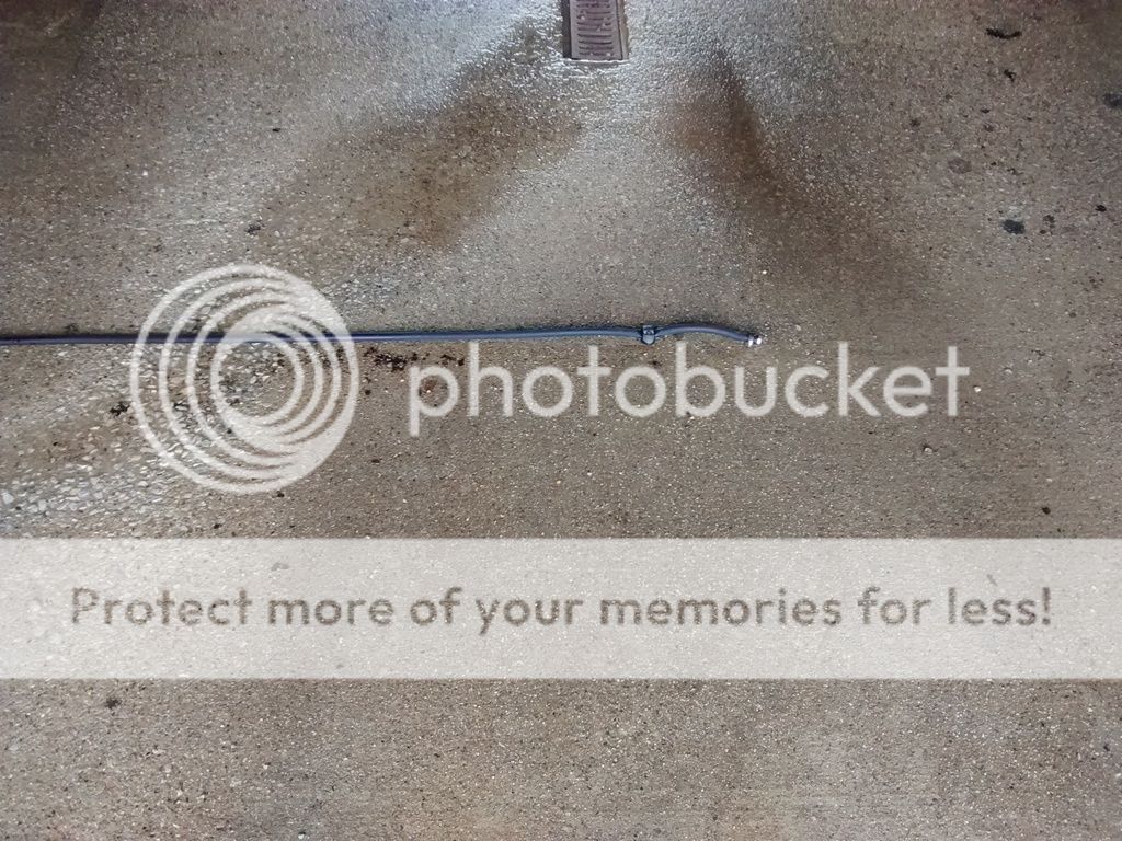

Rear floor, after a busy Sunday, typically the back sits in this zone. The floor drain is under the vehicle when it occurs.
Maybe trim that hose shorter has been a thought. Or its just all the water that builds up at the back of the drain.
Ryko CS
Apr 23, 2012
359
93
Grimes, Ia
Airswitch for activating fixed undercar. They could use either an airswitch or photoeye.

There is one right before, out of pic, and after the uc. Turns on when they go over the first. Shuts off after 4 pulses when the back tire goes over that one you see behind the uc.
