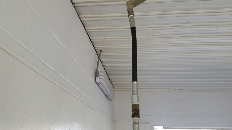

After work today, I started a bay and just walked in circles. The SS swivels at the boom and gun stayed stationary and the BB Fluid Controls swivel did all the work. I tried spinning the SS swivels and they are significantly harder to spin than the BB swivel. In the beginning I watched people fighting with the hose when it bound up from the stiffness of the SS swivels while under pressure. Now you can walk around the car with ease with the BB swivels doing all the work...With one installed inline down from the boom, there is no side pull...Helping them to work easier and last longer.
I use the brass version of what you have at the gun since they take so much abuse, and don't rebuild them. Sometimes I get one that won't swivel well or at all under pressure, but mostly they do. I use the SS one below the swivel saver and take them down/rebuild them whenever I change a hose. They always swivel very well after I rebuild them.
You have a swivel at the top AND bottom of the swivel saver? Seems like a waste of a swivel when the bottom one does all the work. FWIW, I put a 3/8" brass M x F fitting directly into the boom to prevent it being damaged by someone hooking the hose in something.
I left the SS swivels in the end of the boom to keep from wearing out the threads in the boom when I change out the swivel savers (16" short hose). I don't think I've ever taken them out....
