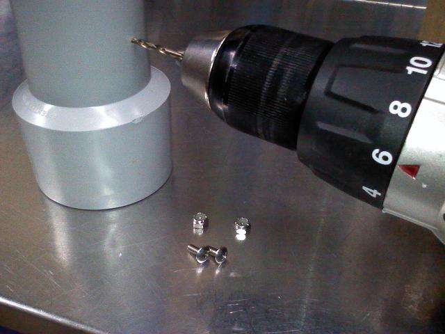

First I cut the cuff just above the ridge that's supposed to lock the claw in the cuff (Customers will still pull the claw out). If you don't cut the claw it protrudes into the hose and prevents it from swiveling.
I insert the claw and drill holes on either side and insert #6 x 3/8" truss head screws.

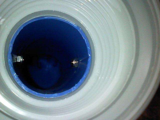

I install and tighten the Nylock nuts to hold the claw in the cuff.
There's nothing inside sharp enough to catch debris.
I've done this with the regular swivel cuffs and the swivel-nut type, and it works on both. I prefer the swivel-nut because they swivel better, but they are more easily damaged if they get run over.
I order ten claws and cuffs at a time and assemble them all at once - it takes about five minutes to do them.
