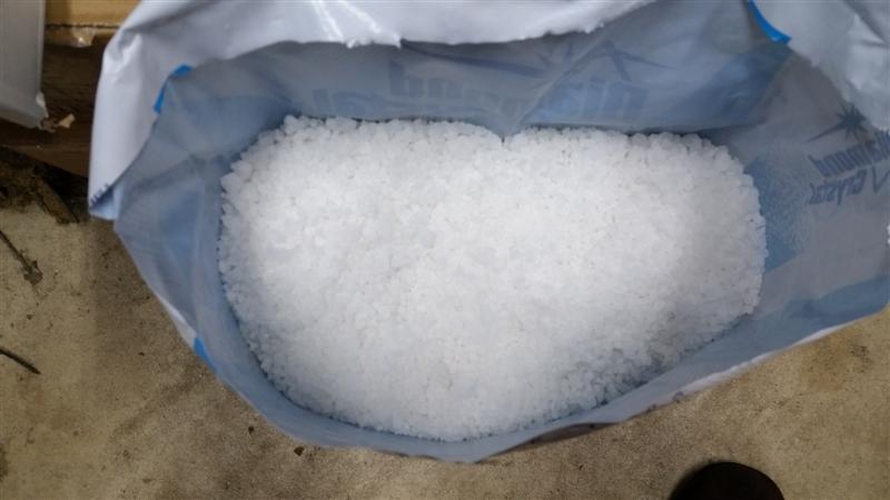

Mep....I'm listening but not convinced! Maybe some others will chime in with their experience with Mortons or Solar Salt. I picked up some Diamond Crystal Solar Salt yesterday and will open a bag to see how "Dirty" it looks. Since the last time my softener was rebuilt (new seal seal kit) was in 2000, and since my softener is 30+ years old, and since a service call is $100+...I opted to spend another $150 and have him rebuild the head....It was my choice...After 16 years of being in service, I didn't know the quality of the seals and internal parts and decided this was the right thing to do.

Mep...This is Diamond Crystal Solar Salt for water softeners...Doesn't look too dirty to me! You sure you're not thinking of Diamond Crystal Ice Melt? I've used it to melt snow and ice and it can look dirty...I guess I shouldn't second guess you since, "You are a Pro"! :rolleyes:
My Lowes and Home Depot has also dropped Mortons...Might be a good time to try this Solar Salt and see how it works...I think the key is not adding too much to the tank...Unless you are running considerable hard water. Mine comes in at 4-5 grains. I soften down to zero...My salt can lay in the bottom of the tank for a very long time...Spanning more than a month...So it may be more critical than tanks that go through a lot more salt than I do.
