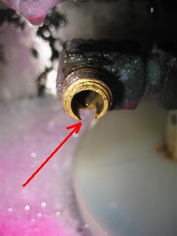

Thank you guys for all the help. Yes it was the diaphragm inside the actuator that caused it after all.
There is a small hole at the center of the diaphragm. Replaced it today and it's working fine now
5,857
2,206
