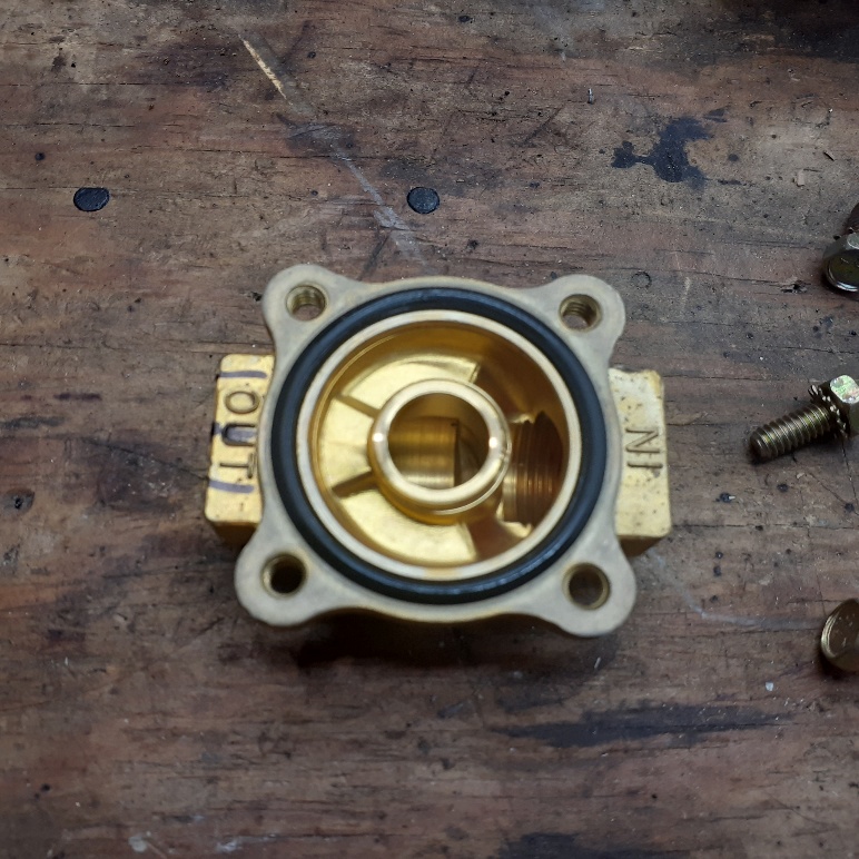

I think you might be mistaken MEP, I had to clean out a couple of my ASCO Weep valves the other day, the city decided to work on the water main and got a lot of plastic debris in the water system. When I opened them up both of the ASCO 8210G34 valves have a stainless steel seat inside. One is over 20 years old and the other is about 8 years old.
Then they weren't the exact same model, Belanger uses the ones with the brass seat.

So curiosity got the best of me. Took my spare apart and it has a brass seat. Hmmm...I still stand behind them! I agree with others on the rebuild kit...They sure are proud of them! About as high as a new valve!!
