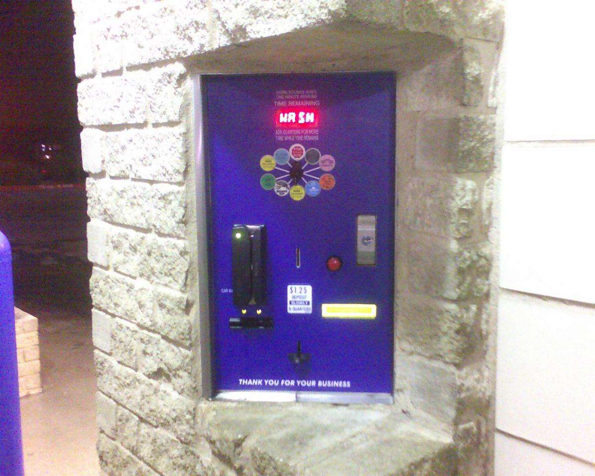

I wanted to thank everyone for all of the help and suggestions as I finally finished my meter box project. I moved them to the end of the bay by building out the concrete wall and also put in new Ginsan all in one boxes with push buttons. I would have never been able to get this done or even the idea of it without this forum. The new boxes are amazing and my customers love them. I also want to add that Doug from Ginsan was amazing during the whole process, from ordering the custom doors, to helping with the install and especially when I had a couple of issues/questions trying to get them going. Here are some pics of before and after:
No idea why pictures keep showing up sideways...

Slash looks good. Are the boxed areas with the doors block or a concrete pour? I am getting ready to do my new place and am going to put the doors at the end of the bays on an angle, not sure if I want to pour concrete or just block them. Place I am doing had vac it up, so i want to re use that. Looks like you used a similar decal to what I used. Glad to hear everything worked out for you.
Jul 8, 2012
2,456
398
Lexington, Ky.
They are a concrete pour. Turned out much better than I expected, just hope they hold up long term. Now I've moved on to phase 2, trying to install my new pump stand.
