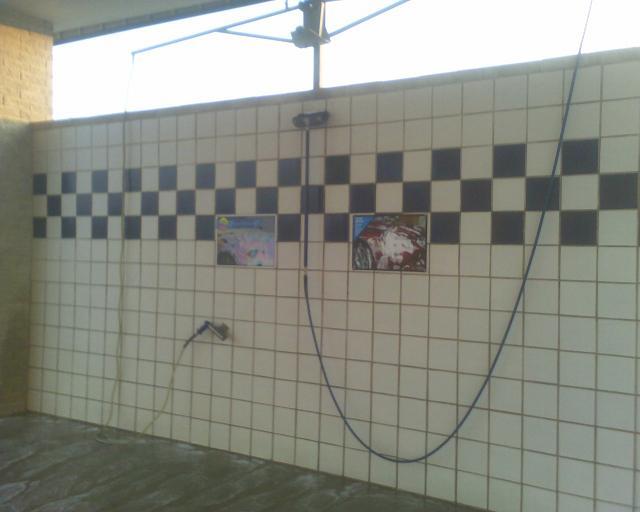

I am adding tri-foam to my bays and need to decide between using a boom and straight hose, or a swivel and curly hose to save room. I think that I could fit a boom once I move my meter boxes and actually already have extra booms, but I'm thinking that if I use the curly hose and a swivel, that might leave room to be able to add tire shine in the future. Is there a big advantage to using one over the other?
3,949
I believe you'd see a lot more use of a tri-foam than a tire shine, but IMO placement of the gun is crucial. I've had a number of people tell me their customers don't use tri-foam, but they always have the gun holder in the opposite corner of the bay from the meter box. I put it on the opposite wall with the brush hanging in the middle of the wall so 1) they can see/hear the gun when they select it and 2) they have to walk past it to get the foam brush. About a third of customers use it.

I agree with MEP. When the tri-foam gun is visible, showing vibrant colors and working I see it getting a lot of usage.

I am adding tri-foam for sure, just thinking about leaving room in case I ever add tire shine in the future. Regarding placement, I only have room on the same side as the coin box. If I use a boom, it will be close to the edge of the wall. Any advantage to using a boom and regular hose as opposed to a curly hose? If you don't mind, could you post a picture of your bay setup when you get a chance?
Thanks.
I think it's a lot easier to walk around a vehicle with a boom than to handle a curly hose, but the curly hose works. It just has to be long enough that the customers can use it without fighting it but not so long that they'll trip over it.

I think I'll stick with the hose. I like how they are both mounted towards the middle. I might just put the TF closer to the middle and that way they will see it as they get out of their cars.
2,876
517
I had to switch from curly hose to straight hose because of freezeups in the winter. I don't know if it would work better with weep, but with blowdown and washer fluid injection, the freezeups was caused by the added length of curly hose. The TF would flash freeze in the hose before it made it to the gun. Even though I keep my trough at 110°. Switching to straight 3/8" eliminated that problem.
