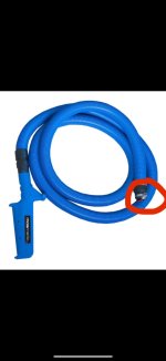

My hoses keep disconnecting/falling out of the swivels on the booms. Does anyone else have this problem? Do you glue them, screw them, etc to the swivels?

duct tape. I don't want them too secure - in case a car hooks them I'd rather have the hose come apart than pull a boom down.

That was my concern with screwing them. I’d much rather lose a hose than a boom. Not sure if the hose would tear if a car hooked it or if it would damage the boom?

Duct tape looks so temporary & trashy. We secure with 4 screws. When a customer snags the hose it unravels at the boom. The hose is made of plastic & the weakest part. The boom won't fall.
