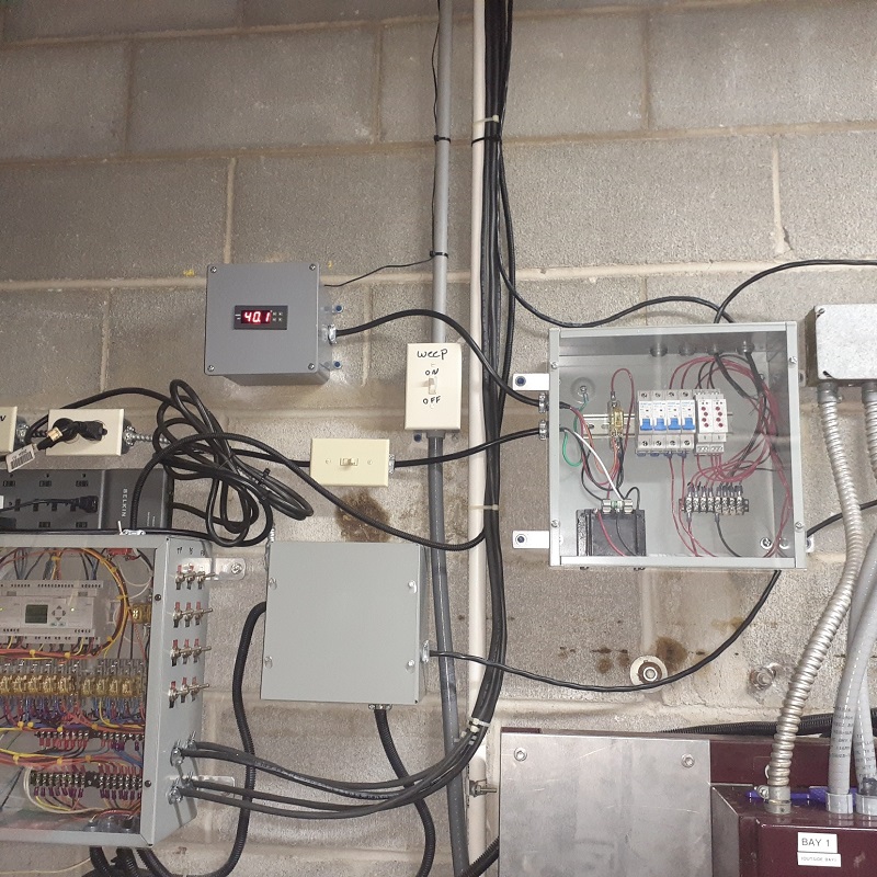

Does it matter if I connect the commons together on the left side or the right side of the terminal? Does the wire need to be ran to the same side of each terminal? For instance the left side of terminal 1 to the left side of terminal 2 and on down the line or can I tie them together from anywhere as long as it block 2 or 3?
3,949
It doesn't matter as long as all the commons are connected together. I would use the same point on each terminal if there's room for two wires.
2,877
520
Do you have and know how to use an ohm meter? It was stated by CB80 and Mep that terminals 2 and 3 are your commons connected in the middle by a jumper. It's easy to see the jumper in the photo. An ohm meter would verify that for you. So the logic is, you can attach a jumper wire from each bay common using any # 2 or 3 terminal on either side of the strip.

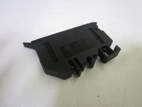

Possibly adding lots of din rail mounted led indicating fuses (quick latch non touch) might be worthwhile on the low voltage side of the humongous transformer similar to those below:
We are now in the process of using similar din mounted fuse holders with their quick disconnect latches in our PLC driven dog wash. Later on I plan on doing a full scale investigation with my Fluke 325 non contact clamp on amp meter when maximum amps are happening & fine tune the amperage of the fuses to give more protection against frying components or sections of components ... time will tell ...

I had the antiquated thermo-disks in each coin box that turned the heat pads on or mostly not on! They were very problematic....Plus I had added so much more load to the 75va transformers I decided to install a dedicated system that only handles the coin box heaters. The system is energized by a very inexpensive electronic thermostat (Thanks CB80!) and is protected by (4) 1a din rail circuit breakers. With a 100va transformer, I would be at about 80% capacity with 20w heat pads. So I added (2) cycle timers (on the right) and wired them in a way so only (2) bays are energized at a time 10 minutes on 10 minutes off. That part was easy by wiring the outputs so 2 bays were on the NO contact of the first cycle timer, and 2 bays on the NC contact of the second cycle timer. That way when both cycle timers are powered from the T-stat, they cycle back and forth every 10 minutes and the transformer only see's a 40w load. It works good at this setting keeping the coin boxes free of ice.

It also went on to state that voltages as low as (1v) may not conduct through the breaker, but line voltages of 24vac should be ok. I remember testing the breakers with 24vac and striking the output wire to ground for a split second. It tripped the breaker like it should. Plus I also have the transformer fused. I would think the 1a breaker you linked to would work fine for this application.

I am thinking there are some advantages to the Allen Bradley fuse quick disconnects or similar that I linked to. Mainly space required & easier to change to a possibly helpful more fine tuned amp protection via those small glass fuses. I am thinking in our dog wash I might be able to go down from 4 amp to 3.15 amp.
To protect the controls on our very special yet safe ... 1000 G-Force laundromat spinners ... we are successfully using the automation direct circuit din rail breakers. 2Biz is right about the din rail breakers rating likely being the maximum.
