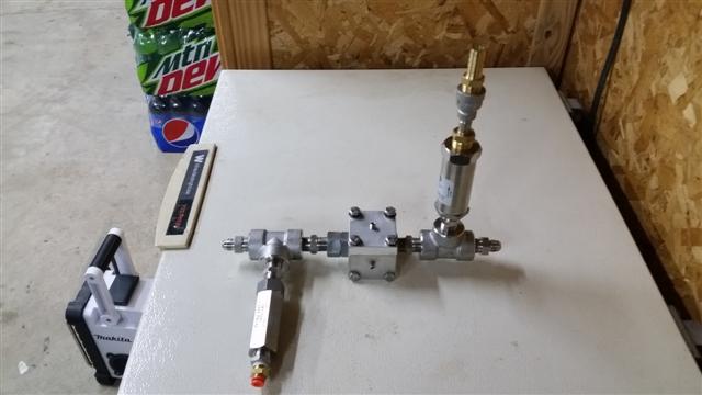

Is that block a downstream injector?
Nope...Its just an aluminum assembly holder I dreamed up...The set screws clamp down on the weep back-flow Cv and keeps the assembly secure. The Cv that comes in at 6 o'clock is the weep Cv. The bottom plate of the holder has a co-bored hole in it to bolt the holder to the pump stand.
My thoughts when designing it, were to be able to remove the whole assembly which would only require me to remove a few hoses and take the top cap off the assembly. I will have a spare assembly to drop in while I service the old one. Problem is, I may not live long enough to have to service one! Maybe not a bad thing as long as it lasts another 30-40 years!

2biz what kind of hose did you use to plumb your pump? I love the clear tubing but can’t seem to find it anywhere.
2Biz are those aluminum flowmeter clamps custom made or off the shelf? That’s my only bitch about those meters...those stupid mounting holes on the back of them.
They are all custom made. Maybe a little over-kill on soap and wax, but I just used a 1/4"-20 bolt to push the flow meters against the opposite side of the slot. It was easy....The (8) PS and FB flow meters were a little more challenging. I drilled clearance holds in the 1/2" aluminum plates to mount the flow meters using the threaded inserts. I needed to get the flow meters out far enough from the panel to use 3/8" LLDPE tubing and this seemed to be the easiest way to do it. Having a vertical mill/drill makes it easier to do more precision work like this!.
