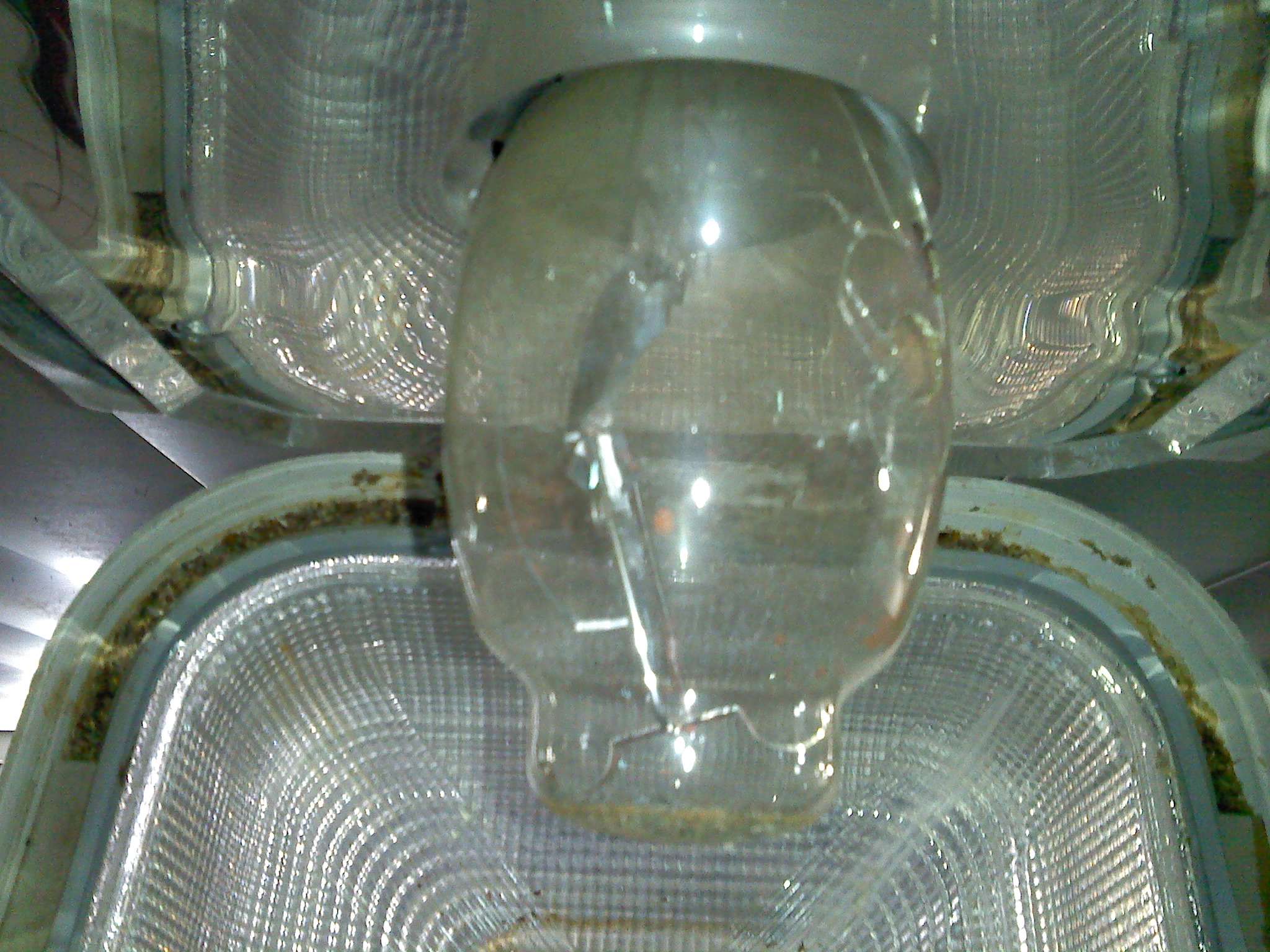

This was one of the last GE bulbs that just failed:

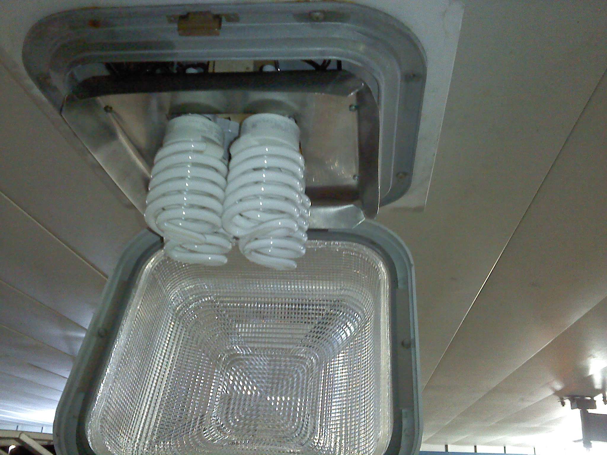

Now for the problems we had. The lamps were really tight in the fixture when it came time to close them. We eventually broke 2 of the CFL's. We tried bending the brace that held the socket a little and finally realized we could unscrew the socket from the frame, reverse it which would give us close to 1/2" more. (Photo below shows the foot of the socket. The screws are under the socket as opposed to being under the wire!) It was not fun but after seeing them lit up this evening and not losing any visual light is a win-win for us. I will order more of the 85W to finish this project.
For the other 4 locations I would like to put in the 105W CFL's. They are the same fixture. Anybody done this in this particular fixture, or any suggestions or recommendations? I'm not prepared to buy the fixtures that Scott is using and our locations are already well lit. I would like to keep them well light, except do it with less of an expense, besides removing all the junk that's in these fixtures would be an improvement in itself!

You know Randy, we did use 1 screw in one of the bases and tilted it up, but I've had more time to think about the install and I'm going to try something else. There is a mound dead center of the fixture that holds the reflector in with a screw and I'm going to cut that out and that would make more room to shove the center of the reflector back. It has to do with the width of the bulb and closing the door.
I called yesterday to reorder more 85W CFL's and they're back ordered to the end of February. I also ordered 12 105 CFL's and I will play with them but they certainly won't fit in our bay fixtures, but will try them in a few misc fixtures that I have. Bummer I'm going to need at least 100 of the 85's and my daughter is chomping at the bit to get started (as am I!)

four of these clustered as close to the center as I could get them.
MEP,
I thought that was a great idea. It looks like my fixture size is the same as yours and I had been holding off trying CFL's because I couldn't get one that was adequate to fit in the fixture. After your brainstorm of 4 bulbs in the fixture, I tried it. I just went to Home Depot and got 40 Watt (150 Watt equivalent) and 23 Watt (100 Watt equivalent) for a quick test with poor results.
It wasn't a fair test because the color on the Home Depot bulbs was only 2700K, not the 4000K that I think is needed so I'll redo it with the bulbs that you linked to.
A question though. The 40 Watt bulbs that I purchased at Home Depot appear to be the same size as the bulbs you used. I could only get two to fit, so in my little trial run I used two 40's and two 23's. Could you post a picture on how you got four bulbs to fit in that fixture?

The bottom of the bulb is about 1/4" away from the lens.
Thanks for the pic MEP, however I think I'm stuck with what I've got.
We have the same fixture, however yours is the "flush" version. Nothing is above the roof canopy and you have access to that large ballast box above the lens. Mine has the same lens, but only the lens is below the roof canopy. The ballast is above the roof canopy and I can only use the space within the lens for the new bulbs and sockets.
I still might try two 40 Watt's and two 23 Watt's with the higher color to see what it looks like.
